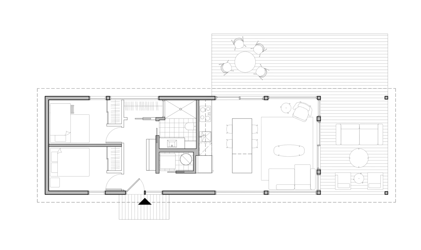

Quote from: blur911 on Feb 27, 2026, 09:46 PMSo, design us a cottage.
We have a bit of a change of sequence of the development.  We now want a small cottage first, as near the beach as possible, which is about 300 feet past where we want the 'bigger'cottage and garage.
We think 16'x28', maybe 30', with a loft over half of it, is a good size.  I've seen a lot of floorplans, none of which work overall, but we can take parts of them and piece something together.
This is about closest so far; https://www.etsy.com/ca/listing/1537728379/16x28-modern-cabin-house-plans-tiny
...but with a bit more roof pitch and less windows, etc.
Almost sounds like you want a large version of a Bunkie.
#32

Quote from: RRocket on Feb 28, 2026, 11:47 PM
Kinda...we want it big enough to live in without getting claustraphobic, but still not spend a fortune.  Eventually we hope to use it for visiting family or rental.

I don't supposed you'd ever consider doing something with shipping containers?  I've seen quite a few different cottage/tiny house plans using them.  If nothing else they can be handy for secure storage on the property.
There's a number of different shed/bunkie builders around NB/NS that can build you what you are looking for if you were thinking about building something more traditional and permanent.  We got a quote from one for a 16X25 "senior suite" that had one bedroom, bathroom, kitchen and living area, completely finished for $75K, you'd just need to sort out the foundation, well and septic, and you'd be in business.

Quote from: Johnnymac on Today at 09:42 AMI don't supposed you'd ever consider doing something with shipping containers?  I've seen quite a few different cottage/tiny house plans using them.  If nothing else they can be handy for secure storage on the property.
Sea containers are handy, we have a 20-foot one right now in Kingston.  I don't like the look of cottages made from them though, some of the bigger ones made into cottages look ok, but I find the smaller ones look like sea containers.
Our builder is a guy who retired from building homes in Quebec and lives just down the road, he takes on smaller projects so he can support his boating.  There's a language barrier, but we're sorting it out.  His prices seem pretty reasonable.
I just wish the septic and electrical guys would call me back...
We might have to build a shed to connect power to, then distribute from there.  So, run a 200 amp service in about 700 feet to a shed, probably about 8'x12' then TECK cable underground out to the cottage another 300 feet further.
